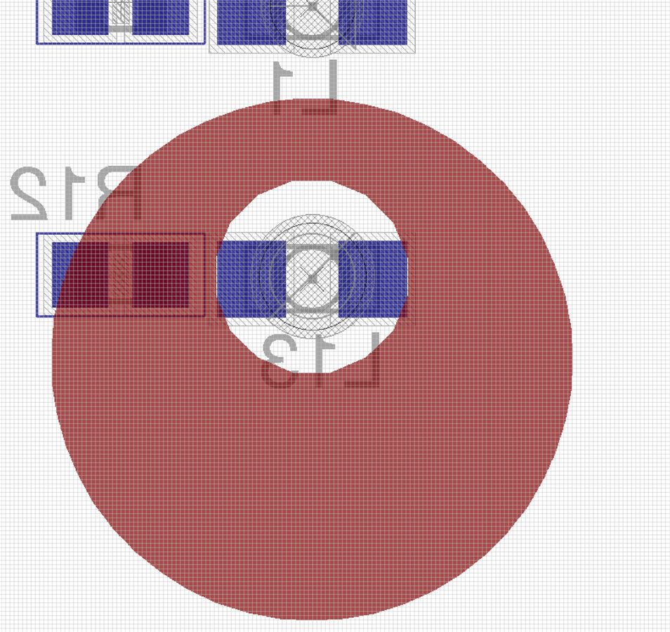

Hi, I have a touch pad which I drew with the help of a polygon. I need a hole in it, but no isolation or minimum isolation. Can someone help please?
I have attached my current screen view, the isolation is too big currently and making changes in the isolation field does not have any effect. Thanks in advance!image

    You can reduce the clearance in DRC, open the 'Distance' tab, and reduce the 'Copper / Dimension' parameter: it's the distance between the copper and the edge of the PCB (works for anything you draw in Dimension layer and for holes).

    Thanks a lot.
