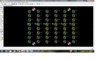

Hi all,
I'm looking to add a couple of variable resistor to my schematic. I looked in the library but didn't find any variable resistors - only potentiometers (granted they can easily act as variable resistors). My task involves a 3-5V voltage supply creating a 15-50 mA current (so resistance is low) so what model variable resistor or potentiometer do you think would work best? I'm new to Eagle so any advice would be great. Thanks!

    0 e14 Contributor over 13 years ago in reply to shabaz
    My PCB design is shown above. I initially had put resistors but then realized that a variable resistor would be better in case I wanted to change the resistance to increase the current. What is not shown on here is that there will be a 3.5V-4.0V voltage source that will have each of its pins attached to a variable resistor for each set of LEDs, respectively. The ideal amperage is between 20 and 50 mA. Hope that helps, thanks!
    0 shabaz over 13 years ago in reply to e14 Contributor
    Hi Anup,
    Could you share your circuit, component values, and what you're trying to do? It's confusing if you need a current source or something else. Either way, relying on a trimmer alone to provide 3 ohms doesn't sound right.
