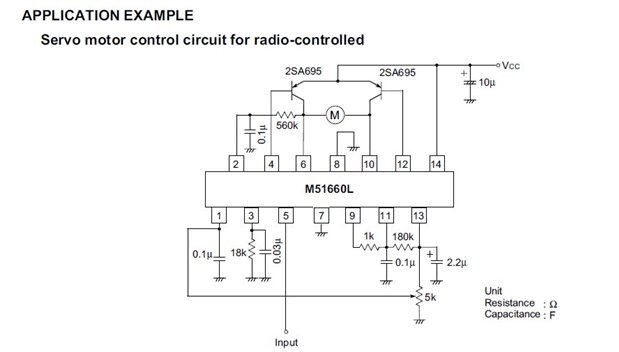

Hi, I am wanting to make a 16mm X 17mm PCB servo controller using the M51660L but I can not find a library that has the M51660L in it, can anyone help?
This is what I want:If anyone has already done this I would like a copy.image
I have a pile of burned out MG996r servos and would like to repair them.
Thank you,

    Hi Wayne,
    I hope you're doing well. I would encourage you to look through Chp. 8 of the EAGLE manual for a tutorial on how to make library parts. This will allow you to make the part yourself, to your requirements. It takes a few hours to go through but it is well worth it.
    Let me know if there's anything else I can do for you.
