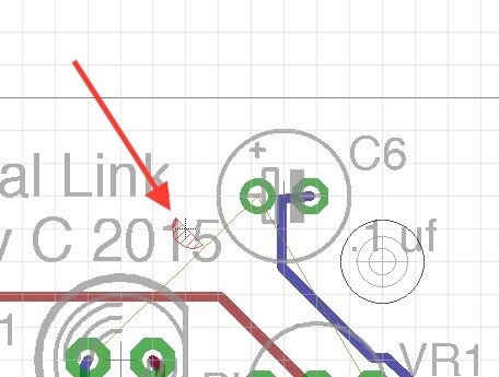

I have been working on a board and I have this half moon shaped outline on my board.
I just want to delete it. However I can't select it nor know what it called so I can research what is it.
Can anyone give me a idea what it is called and how I can delete it.
Attached is a screen print with a  red arrow pointing to the little devil image
Thanks in advance for any assistance you can provide.
Neal

    0 plocher over 11 years ago
    These cross-hatched shapes are artifacts of a DRC run - the half-moon shapes typically indicate that a clearance problem was found there at some point.  You may also find hatched line segments that indicate a mismatch between your Edit->NetClasses line width requirements and the actual board layout.
    To remove it (and other such artifacts), rerun the DRC tool; and if/when it shows a list of "problems", fix them, accept them, and/or "clear" the list.  An error-less DRC will also clear the artifacts.

    Looks like a left-over DRC tell-tale. Open the DRC results and clear them.
