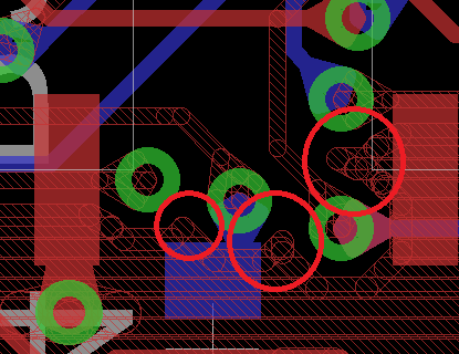

Hi
I want to set restriction area for adjusting edges surrounded red circles in the following picture.
How can I set restriction area like tRestrict and bRestrict on other layers?
Best regards

    Hi,
    You can add a cutout polygon in the 2nd and 3rd layer.
    Guillaume

    Hi, Gauillaume.
    Thank you for your great advice!!
    I investigated a cutout polygon and found this movie.
    https://www.youtube.com/watch?v=9Q3fvy0Xim0
    Then, I could solved my problem!
    Thank you so much!
