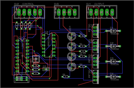

Hello All. This is my first attempt at using Eagle software to develop a printed circuit board. This project is for the purpose of jumping into the program to gain a foothold on learning it's ways. I've come accross something that I don't understand so I've come asking for some help. As seen in the board image, IC1 (L297) is a DIP. It looks to me that pins on both sides of the chip are shorted to adjacent pins. Anyone have an idea of what's going on? Thanks. - Scotty

    The images are of pretty poor resolution so its hard to tell.    Some of
    the (non- adjacent) pins are shorted together but it appears that the
    schematic has the same connections.
    I do not see a case where "adjacent" pins are shorted.    You do
    understand that editor is showing you multiple layers?   The blue traces
    are on a different layer of the board than the red traces.   Although
    these traces do cross each other they are not electrically connected
    unless there is a via or pin also connecting the board layers.
    Why not use the "show" command to display the nets on your board.   This
    will quickly tell you if there are connections between adjacent pins.

    Thanks for responding Jim. I inserted some new images. They are readable now. Yes, I do understand about trace colors and board sides. When I use the Show tool on a selected 'problem' trace, the trace and only the intended component pins of the selected trace illuminate. However, that trace has a path right along the drill holes of adjacent pins of IC1.

    Ok..I see it now and it does look wrong.   How did the traces get routed
    this way ....manually perhaps?   Try running DRC and see if the problems
    are picked up in the check.   I think the suggestion to post your sch
    and brd files makes sense.
    Jim

    I looked at your files and I see some things that are beginners failures.
    I would advice you to first look at the tutorials to see how things are working.
    Use the ERC/DRC to check for consistency and errors in schematic / PCB layout.
    Keep your hands of the Design rules as long as you don't really know what you are doing and look if you can find DRU files at your boardhouse for eagle.
    Use VCC instead of 5V for digital power this because when you look at IC2 in the PCB you'll see that power is not connected.
    Also for GND instead of AGND (AGND is analog ground and not Digital GND).
    Also check trace sizes, the traces at the 24V is way to thin when looking at the maximum current the MOSFETs can drive.
    Advices you to define extra NETCLASSES for power and 24V with wider traces and use a polygon for GND.
    Did you route the board by hand or autorouter? If you can use the autorouter you better try these will respect the design rules.
    Whe you have more wuestions don't hesitate to ask.

    Hi Robert,
    I also looked at your files and agree with Marco's suggestions.   I
    tested the layout by running DRC and there were many reported overlap
    errors ..some of which you had pointed out.   I then ripped up all the
    traces and auto-routed the board and it did not re-create the overlaps
    in your original design.    From these results it appears likely that
    the original layout errors were created during a manual routing procedure.
    You may have been expecting that Eagle would automatically avoid other
    traces/nets/pads/vias but in the manual routing mode it does not.   If
    you have a version of Eagle that supports the "follow-me" routing modes
    you get something like the behavior I think you were looking for so
    maybe you want to experiment/read up on that feature (added around
    version 5.10 I think).
