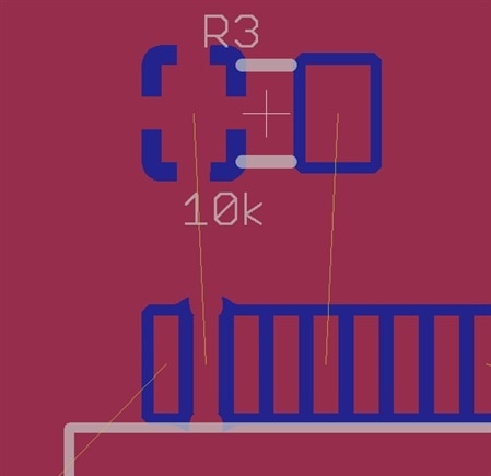

I'm trying to connect my ground to a LQFP-64 (10x10mm) but it doesn't seem to want to connect in Eagle 6.1.0. This used to work fine in 5.10.0. I have the polygon isolate set to 0. My DRC supply thermal isolation is set to 10mil. I've tried reducing the isolation but it still won't connect. Here is a screenshot of what I'm seeing.  If I route a wire from the pin to anywhere on the ground plane and then run DRC it works fine but this is kind of a pain.

    Attached images does not work here.
    Have you renamed the polygon so it's named GND ? If not, they will not
    connect.
