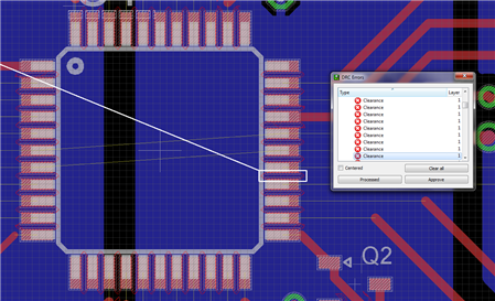

I've recently run into a problem with Eagle that I've never had before.  I've done quite a few layouts with a 44-pin TQFP package, but with my last design the DRC gives me errors on the spacing between the package's pins.  I'm using the same .dru file as I have previously, and it still works with my other designs, just not this one.  I've attached an image showing the spacing errors.  Any thoughts?
    Resolved:
    The net class clearance was set to 24mil instead of 0, so it was overriding my DRC clearance settings.  Set it back to 0mil and it fixed it.
