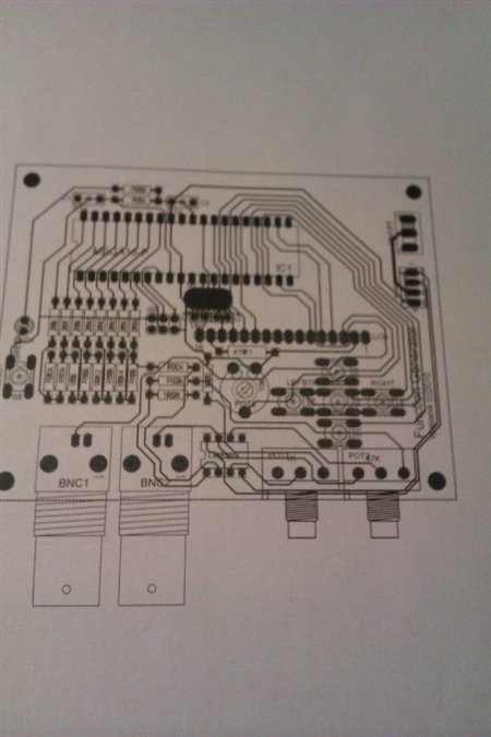

Hello,
I try search google, but i can't find anything about "printing groundplane".
I'm a begginer in Eagle, but i download this project -> http://www.electronics-lab.com/projects/test/013/index.html
I need, make printout for photocopy transfer of this board In Eagle.
For test i select all layers, but when i make printout i got this ->
instead of this
http://www.electronics-lab.com/projects/test/013/PCB_bottom_th.png
The groundplane is missing.
I see this in eagle, it exist but not on printout.
Please advise me what i should do.

    I'm not 100%, but it looks like you haven't clicked 'Ratsnest' to fill the open areas with the copper pour. When you are in board view, click the ratsnest button on the tool bar to the left. This will fill the ground plane and hopefully you will be able to print and obtain a result similar to your figure 2.
    Hope I helped,
    Best
    Chris

    Hello,
    Sorry for late reply Chris.
    You'r solution solve my problem so Thank You very much.
