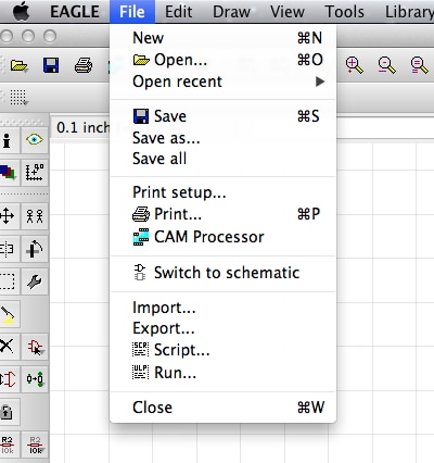

I am trying to run a CAM job, but when I go to File > Open there is no option to open a job.
I expected the menu to look like this (from sparkfun totorial)
http://www.sparkfun.com/images/tutorials/BeginningEmbedded/9-EaglePCBs/EP-28.jpg
But I get this this from my File menu.  The Open field doesn't expand so I can open a Job:
I'm using Eagle 6.3 on OSX 10.7.5

    Scott Goldthwaite wrote on Thu, 17 January 2013 08:53
    s/EP-28.jpg
    Image:Screen Shot 2013-01-17 at 8.45.26 AM.png
    Hi Scott,
    You have to open the CAM processor and then File->Open from there.  If you
    do that from schematic editor or board editor then there is no option to
    open a cam job.
    Also, make sure that the CAM processor has loaded the correct board file.
    The easiest way to do that is to open the CAM processor from within the
    board editor you want to create CAM files for.
    Cheers,
    James.
