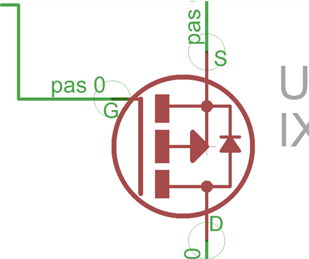

Hello,
I've a novice user of EAGLE CAD and I've come across some troubling behavior.
I am getting false ERC passing on the consistency check between the schematic and the board.   I have no physical lines either on top or bottom running on the board at all, and when I run ERC, EAGLE reports back that the schematic and board are consistent.   Nope!  They aren't, I have no traces on my board, EAGLE.   I wanted to make sure I'm not crazy, so first I made 100% sure:
-- I've routed nets to the MIDDLE of the green pin on all parts   ( they are )
-- The green wire are NET wires and not LINES.   They are present on the NET layer.  ( yes, they are )
--  The green NET wire & the red symbol lines intersent at 1 point inside the green circle representing the pins ( they do )
-- I've checked 3x  that the symbols and net lines are on-grid 0.1", as well as the pins   ( they are )
-- I've tried moving the schematic symbols once routed to make sure the rubber-band behavior of nets/symbols is present in the schematic for all parts ( it is )
-- I get the proper flight lines / rats nets lines when the new board is created, and they match the schematic  ( they do )
Still, ERC reports back that the board / schematic are consistent in the case of totally missing top/bottom traces on the board.
NOW, the interesting part:
-- When I route a net wire through the green pin, so that the wire extends more than halfway through the green pin,   THEN,  running ERC,    EAGLE reports back that the net is actually open and that the trace is missing from the board.  Look closely on the G pin as opposed to the first picture:
What am I doing wrong here?    In the first picture I am clearly inside the boundary of the G pin, the flight lines exist on the board, the symbol and wires on it are rubber banded, but ERC reports no errors for unconnected traces.
In the second picture, ERC correctly reports an open circuit on the board.
???    Stumped    ???

    I think you are not understanding ERC vs DRC vs consistency check.   When your schematic and board are consistent this simply means that they agree at a component/netlist level....does not mean that your pcb is routed.     ERC is checking for various types of errors w/ the schematic...stuff like nets that are connected to only one pin,  outputs connected to power, etc.    DRC checks for stuff more related to the layout ( traces overlapping each other,  two drills on top of each,  traces to close to the edge of the PCB,   silkscreen inside unmasked copper,   traces too close together).
    Perhaps you are looking for the ratsnest function which, in addition to (re)drawing minimum length airwires, will report a count of how many unrouted connections you have.     If you have routed everything then ratsnest will report "Nothing to do" ....but this does not mean that you layout is free from the type of errors that DRC picks up.    You need both ratsnest and DRC.
    In case you have not run into yet ALWAYS keep the schematic and the board open simultaneously.    This will preserve consistency between the two.
