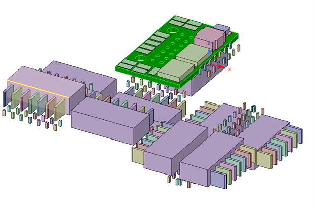

The generate_3d_data script has fallen into disrepair and hasn't seen any improvements in over two and a half years.
I needed to generate 3D board data for a customer, so I took the opportunity to make some fixes.  In my research I found that FreeCAD (exactly what it sounds like) has an IDF import function.  Unfortunately that module (idf.py) is not installed in the default Windows distribution, but it is easy to copy and paste.
The old version of generate_3d_data had many issues that were incompatible with the FreeCAD import filter.  With some guessing and testing I made it work.  I think the rest of the operation of generate_3d_data is unchanged.  It may still have some pre-existing bugs, and I may have introduced new bugs.  For my purposes it seems to be working very well.
What I don't know know is if this new version is compatible with other 3D CAD packages.  I have a friend testing SolidWorks, but I don't have access to any of the other packages.  I would appreciate help testing if you have other systems available.
From FreeCAD you can generate STEP, IGES, and many other formats after the IDF file is imported.
The new version 0.90 ulp is attached.
Merry Christmas!

    Hi Barry,
    there's still a problem with packages, that have 3D data on the bottom ECAD layer 50 "bCAD". Here's an example of a THT female connector. In the tCAD layer 57 there are the beginnings of the pins and in the bCAD layer 58 there are the endings of the pins. generate_3d_data_v091.ulp generates wrong angle data, if your package is places in other angles than 0° or 180°. You see in the picture on the left side packes placed in 0° and 180°. No problem here. The pins on the bCAD layer are at the same x/y-Coordinate as on the tCAD. On the right side you see packages rotated to 90° or 270°. The bCAD-pins are rotated in the wrong direction.
    Data in *.emn:image

    So I had a look into idf.py and I think there is a bug in the line
    that handles the drills.
    if current_section==".DRILLED_HOLES"  and section_counter>2 and float(emnrecords[0])*emn_unit>ignore_hole_size:
             drills.append([float(emnrecords[0])emn_unit,float(emnrecords[1])emn_unit,float(emnrecords[2])*emn_unit])
    changing 'section_counter>2' to 'section_counter>1' produced the
    missing drill.
    Lorenz

    Thanks for testing the script and reporting the details of your results.
    The first problem with the old versions was the "both points are equal" error in FreeCAD.  The old versions basically repeated all the points twice in the .emn and .emp files.  This may be legal in IDF, but the FreeCAD importer did not care for it.  I fixed this and another error that appears after you fix that one.
    The parts in wire frame issue I don't think is fixable with the script.  It may be a setting in FreeCAD.  Was FreeCAD in wireframe mode?  I am not a FreeCAD expert at all.  I do not get wireframe parts, but the IDF format doesn't really specify solids or wire frames, just points.
    I confess I found the misplaced bottom parts issue shortly after my post yesterday.  It was only a problem with multi-outline parts placed on the bottom, but for me it is fixed with the v091 file attached.
    Odd only one of two vias would show up.  I don't have an explanation for that one.  I have 4 large vias for mounting holes on my board, all 4 show up.  It is pretty easy to open the .emn file with a text editor and look at the hole call outs.  That would tell you if the script isn't finding the hole, or if the importer isn't importing the hole.  I did set the via limit too low once and it caught all my signal vias.  The script handled it well enough, but FreeCAD always crashed before loading the entire design.
    Pretty sure the .ulp does not look at the dimension layer in packages.  If it isn't on layer 50,  57,  58, or a through hole pad it might as well not exist for this version.
    I don't use any cutouts on the board I am testing, so I have no results.  As I recall from using the old version a few years ago, there were issues with the cutouts.  I didn't touch any of the code in that section.  If I remember correctly, when I made components with cutouts on layer 50 and it handled those better than using cutouts directly on layer 50 of the board.
    The new script does rely on components in the schematic so it can find the original library part dimensions and angles.  The IDF format uses library parts then placement of those library parts, much like Eagle.  The old version of the generate_3d .ulp made a new part for every rotation and mounting side of each part found on the board.  I changed that.  Possibly this is not helpful for board only designs.
