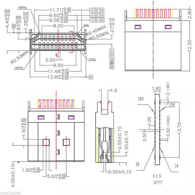

I need a foot print for an HDMI PCB SMT connector. Any ideas as to where I could find one?

    It's easy for you to say "I just don't get it" because you have the experience. People come here for help because they're not familiar with the procedures. When you don't know how to do something, it becomes a challenge. It might be simple, but it isn't simple until you learn those features. I myself am looking for the HDMI Male Connector footprint, and can't seem to find one anywhere. I gave up and tried to create the part in eagle, but for me it was too much information and things to learn. I was also a bit scared that when I order PCBs these could be wrong.
    If anybody else have the Male connector HDMI footprint, please let me know. It's a rare part, since most connectors are female. I attached an image of the connector. Thank you.image
    I could find one?
    I've drawn one, but its untested. Actually I would recommend not using SMT
    for HDMI connectors, as the force applied when plugging and unplugging will
    physically result in some material fatigue somewhere. Only if you have
    flanged version and VERY ridgid support on the flange, you may consider it.
