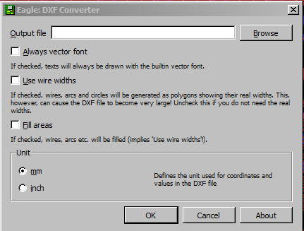

Hello,
dxf.ulp gives error: "Can't fill polygonwith Width = 0".
No matter what layers I have "ON" the error message stays same.
I'm trying to export .dxf to so that I can make a test jig with CNC machine.
Thanks,

    As the error says. In your design you have a polygon defined using zero
    width wires. Give the polygon wires a sensible width and you wont get
    the error.
    All the best
    Warren

    I removed all polygons (I could find) with Width = 0. But still get the same error message.
    Is there a way to find out if I missed some?
    I thought that only the layers that are "ON" would be exported. Exporting whole design with tPlace, bPlace, tNames, bNames etc is unnecessary when I only need coordinates for about 100 test points.

    Run statistic-brd.ulp
    The polygon tab will tell about the polygons you have.
    HTH
