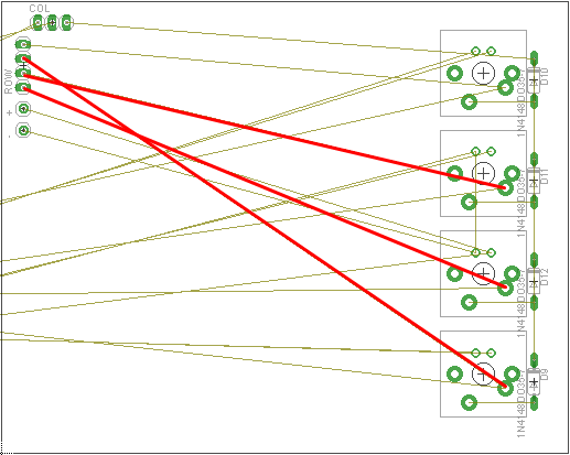

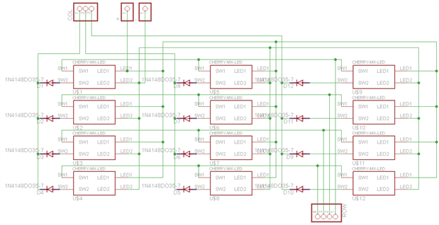

I'm working on a PCB for a 3 x 4 Matrix Keyboard, however the pin headers are acting rather peculiar.
In the schematic, on the pin header for row, I've wired pin 1 to the top, 2 to the second down, 3 to the second up, and 4 to the bottom, however in board view pin 1 is wired to the top, pin 2 to the bottom, pin 3 to second down and pin 4 to second up. Does anyone know why this is? How can I fix it?
Below are my schematic and board. Incorrect wiring is highlighted on board.
Help would be much appreciated. Thanks!

    e14 Contributor over 11 years ago in reply to shabaz
    Hi,
    I don't know why I didn't think of that! That worked perfectly, thanks.

    shabaz over 11 years ago
    Hi Emil,
    The schematic is a logical representation, the board layout is a physical one. They won't necessarily match 1:1 - that is up to you. If you want them to match, then in the board layout you can drag the lowermost switch and position it at the topmost position, and so on..
