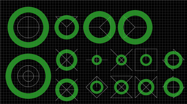

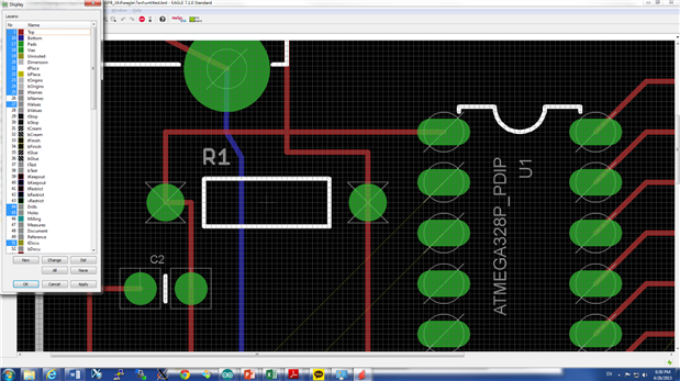

So basically, I cannot see the drill of Via on Layout editor. I attached pictures
The right one is layout practice example from Sparkfun site. I tried to draw the same thing but as you see there is no holes and just filled pads shown on my layout editors.
If I checked 44 Drill on Display it just show the stupid lines on the pads sometime X sometimes Square or just line....
Can anybody help me to figure out this?
The thing is.. I don't know whether it is Via with through-hole or just a pad for the electronic component... It is really annoying..

    autodeskguest over 11 years ago in reply to e14 Contributor
    On 27/04/15 21:07, David Kim wrote:
    One more question is that, is there any meaning for the different mark
    of the drill? Depending on different drill size, it shows different mark
    as it shown on the pictures.
    They're distinct marks to show the different drill sizes, that's all. If
    you're setting up a drilling machine you need to know that, and if
    you're checking the drilling patterns you want it to be clear to see.
    Having the different markers shows it much more clearly than if you were
    trying to judge whether two holes are the same size.
    e14 Contributor over 11 years ago in reply to autodeskguest
    One more question is that, is there any meaning for the different mark of the drill? Depending on different drill size, it shows different mark as it shown on the pictures.

  • autodeskguest
    pictures
    enter the following into the command line
    SET DISPLAY_MODE REAL
    That will solve your issue. Then understand what it was all about,
    search the HELP for 'display_mode'
    HTH
    Warren
