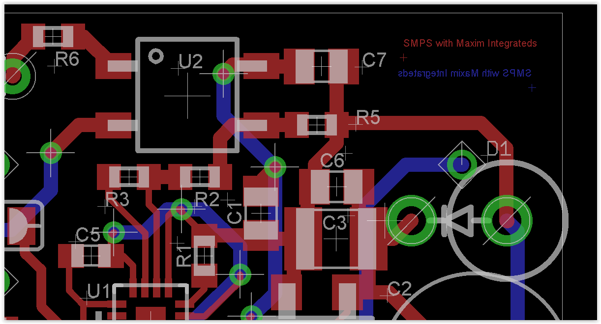

Hi all,
I m new at this forum. Generally i can find what i m looking for it by googling it. But this time i couldnt.
On the PCB layout i m staring at the top side of my circuit. I can see the bottom side but it s all mirrored ( if i type anything on my pcb letters re mirrored. Look at my screenshot for that) . I just want to change my point of view and see from the bottom, so i can see the straight blue copper and mirrored red copper. It s easy to change that thing in Proreus.
I hope someone could help me with my basic problem.
Have a good day.

    J Mc wrote:
    Use TOOLS > MIRROR BOARD
    Josh Mc
    Hi Josh,
    That does work to an extent but it's not a true bottom side "view". The way that works is it mirrors everything and renames all the layers so it is physically altering the design data. I believe it also doesn't work correctly if there are locked components. So whilst it's useful its not a proper solution.
    Best Regards,
    Rachael

    You most certainly DO need to be able to view the bottom. When you are looking at a stuffed PCB on your desk and want to make some changes to the bottom (say to fine tune some physical enclosure clearances) you want to see the same view as the PCB you are working with, not some sort of mirror image.  This should be a fundamental option in Eagle--why would it not be included?  Several low-end packages are beginning to surpass Eagle's feature set.

    Following on from my previous post, I quickly knocked up a ULP to do this. It's VERY un-polished at the moment as I only spent a few minutes on it but it works. If I finish it off and/or add more functionality I will try and update it on here.
    showside.ulp.zip
  • rachaelp
    0 rachaelp over 10 years ago in reply to e14 Contributor
    Hi, you don't need to use ULP to do this just two script files with appropriate DISPLAY commands to turn on/off the layers you want to view. You could use ULP's if you wished, create a string containing the appropriate DISPLAY commands and pass it as a parameter to exit().

    0 e14 Contributor over 10 years ago
    Hello again,
    Yes now i m using "display" command to on or off the layers, its cool but also i would like to assign a key or a button to do that for me. And also i found a rendering program called zofzPCB for windows now i am using this to 3D view. But it takes many effort and also i could not see my 3D components there. I ll find an application for directly rendering from .brd format for Windows. I also used show command but my problem is not with the tool i could not see the difference between highlighted and not highlighted nets. It is about the color contrast or something. I believe i have to get used to it.
    Thank you Rachael for your help. Have a good day.

    Hello,
    Are you saying you want to flip the board so you can see the traces better on the bottom for routing because the top side traces obscure your view? If that's the case you can turn the top side layers off and see just the bottom side.
    You can also export from EAGLE into 3D tools if you have the right add on software. CADSoft seem to have partnered up with a 3D CAD company to provide this feature and I am sure there are probably other open source options available too but I haven't explored them. On the Mac there is an app called Copper which is really cheap and amongst many other things does excellent 3D renderings of EAGLE boards directly from the .brd file.
    Finally, if you want to highlight a net in the board easily then name them to something meaningful in the schematic, eg. UART_TX for the transmit from a UART, then in the layout you can type:
    show UART_TX <enter>
    This will highlight the entire UART_TX net. Unfortunately the highlight will disappear as soon as you select any other tool which is really quite annoying. There is an open feature request for a proper highlight feature which I am hoping will be in an upcoming release but who knows as we don't have any visibility of what the team at CADSoft are actively working on sadly.
    Best Regards,
    Rachael
