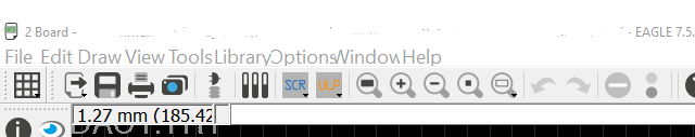

Hello, when I move a window to my 4K Monitor, the menu font is too big:
the problem only occurs if the window is moved to 4K monitor, or if the window is maximizedin the 4K monitor;
if the window is started in the 4K monitor, the font is ok:
Can this be fixed in an upcoming release?
Regards,
--Vito.

    I understand Eagle needs fine control of the screen in the drawing area; maybe control requirements don't apply on menu bars? (e.g. I suppose they are entirely handled by the QT framework?)
    If you look at second picture, on first creation the menus are ok; only the handling of the resize event is problematic, so (maybe) it is a bug that's not so hard to fix.

    Hello Rachael,
    just tried 7.5.2 beta: same behaviour as 7.5.0. I'm going to post on Eagle Suggest forum.
    Thank you very much for your suggestions!
    --Vito.

    Hi Vito,
    Have you tried the latest 7.5.2 beta? They have put some HiDPI display enhancements into that which relate to menus and dialog boxes. I've seen improvements on OSX, I'm not sure what they have done for other OS's. If you don't see any improvements relating to your specific issue it might be worth raising it as a request in the Eagle Suggest forum area so the devs see it, especially as they are beavering away on this area of the code at the moment!
