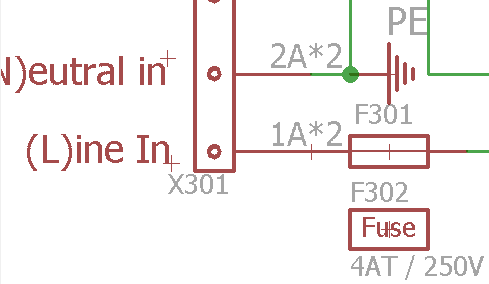

I can't find parts in the bom that are only in the schematics and don't have a body in the board.
This is e.g. a fuse that is put into the fuse holder. The fuse holder is a normal part in the schematics and  in the bom (F301).
The fuse F302 was drawn as part in the schematics only. it is placed beside the fuse holder.
The fuse will not be exported to the bom with the bom.ulp
Any ideas or different apprach?

    The bom.ulp takes only parts that have packages assigned. With a quick
    modification in the bom.ulp you can have all parts including those w/o
    package. But will also see a drawing frame , supply symbols and so on...
    Attached the modified ULP.
