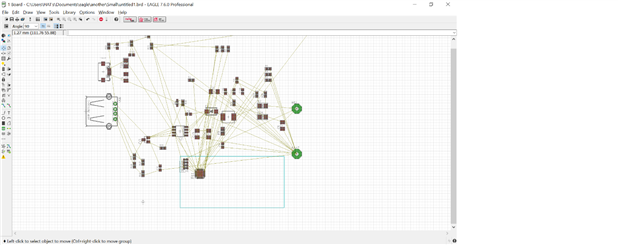

How to connect Polygon with any pin/signal?
hassanfarroq.hf
hassanfarroq.hf over 10 years ago
Hello,
I'm new here and to eagle. Let me try to explain my problem. Instead of creating a schematic, I directly created a board, and connected all the grounds to a pin, where i'll connect negative terminal of the battery. Now i want to create a polygon which is linked/connected to that pin to simplify my circuit. I've tried creating a polygon on the top surface and keeping the name of pin and board same, but that didn't work. The negative pin is named NAAT.

    Ratnest should fill in the polygon and get the air wires to go to the
    closest point.
    Show NAAT  should highlight the polygon and any pads with that name.
    Paul
