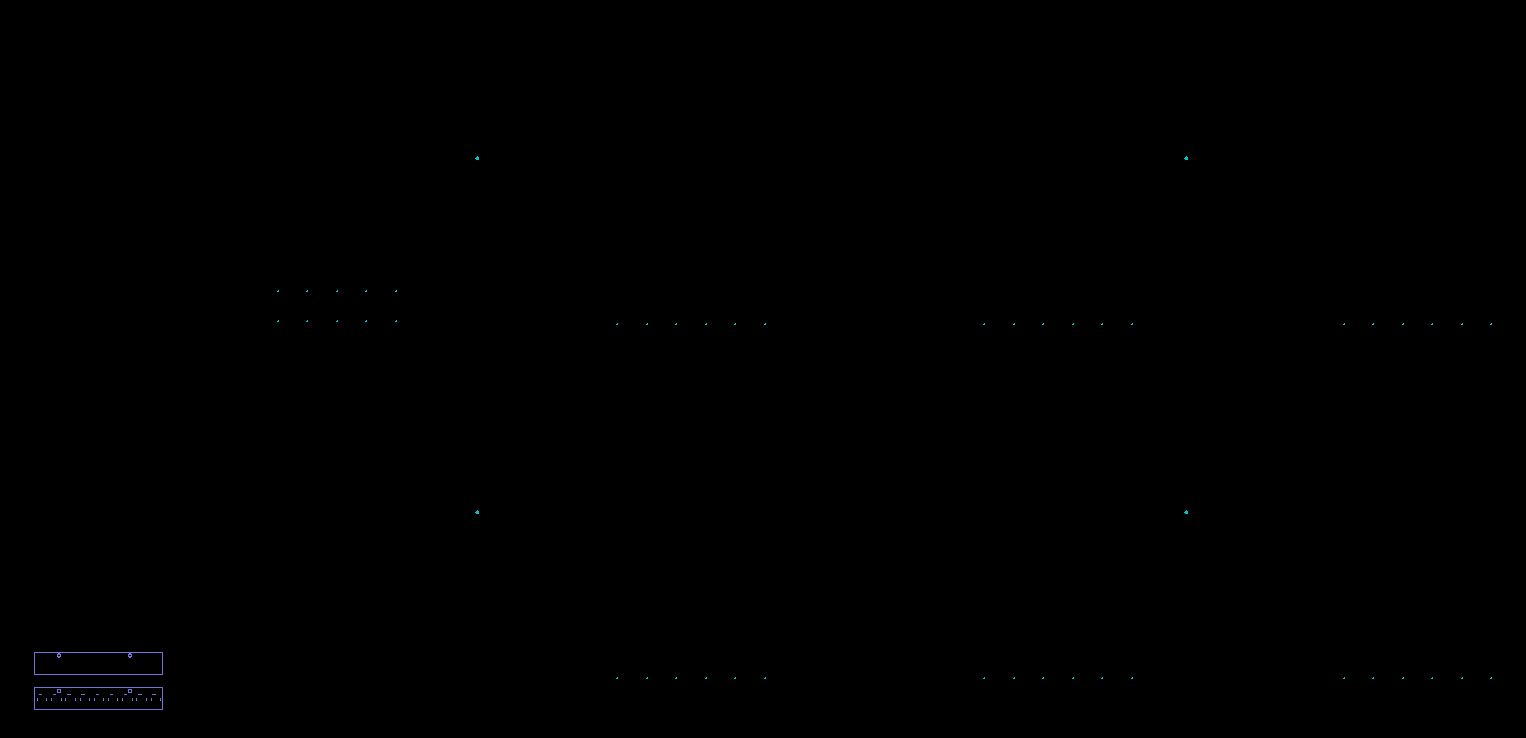

I've recently upgraded to Eagle 7.6.0 and I'm now having serious issues with exporting Drill data via the CAM processor.
The exported Excellon file does not match the .brd file at all - it's completely different.
I'm using an Eagle file that was exporting successfully in previous versions and a CAM job file that I've used for years.
This problem seems to have started with the upgrade to v7.6.0 and seems to affect all my Eagle files.
The pic below shows what I'm seeing in the Gerber Viewer. You can see the actual board in the bottom right hand corner but something has added all these extra drill files outside the board area!
Can anyone help with this?

    Changing from EXCELLON to EXCELLON_24 seems to have solved the issue.
    Does seem like there is some sort of resolution/scaling difference between versions/output methods - I can see now that my original output wasn't "completely different" but just a scaled up version of the main/biggest holes on the board.
    Solved - thanks, much appreciated.

    I have seen this with earlier versions too. In my case it was just incorrect units and gerbv wasn't correctly detecting the unit and scaling accordingly. I think you can adjust it to tell it what the actual units are. I remember playing around this a while back and resolving the issue but I can't remember what I needed to change from/to.

    I hope you're doing well. They are not extra holes, they are the actual
    holes of your design. The gerber viewer incorrectly guessed the format
    of the excellon file.
    Newer versions of EAGLE have more precision in the CAM output by
    default. On small boards or those with few features the gerber viewers
    can sometimes guess the format incorrectly.
    Just specify the format of the excellon file and it will be good. Here's
    the format
    2.5 (1.5 is same) leading zeroes suppressed absolute inches
    hth,
