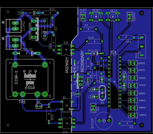

A total newbie to eagle design and PCB fab. So plase bear with on my silly questions, trying to learn.
I have pcb that is schematically completed with the layout. Before i start the fabrication process i need some expert advise if the components placed and the wires routed are ok for the ac mains and the others. The load here will be a transformer. The ac mains are 240VAC and all works well as designed in the schematic on a bread broad except for the load for which MOC3023 is yet to arrive from where i've ordered.
Thanks in advance.

    On 04/09/16 19:23, George Thomas wrote:
    Now about placing the components, will keep the AC components as close as possible with the widest copper. The space between the pins is short so that would limit the copper size there would that be a problem ? I mean the route to the TRIAC would be. I've rearranged the AC components closer. how are the track size for the other components looking ?
    The shorter those tracks are, the less it matters if they're not as wide
    as you'd like. Basically, the copper track acts as a (low value)
    resistor, where R = k.l/w (give or take). Short and fat is the lowest
    resistance and hence gets least hot.
    It looks like you've changed to a different triac in a wider (TO3-P)
    package, which will help with wide tracks! If it were my design, I would
    move the small transformer to the right a fraction and put the triac
    between it and the connectors. That would, I think, allow the shortest
    track from the "AC" connector to the middle pin of the triac. Well,
    other than placing the triac between the connectors and swapping the
    connectors so that AC is towards the top.

    Yes your correct on assuming that the TRIAC is just a basic switch. It switches on at for predefined time set by the pot (R12). The time ranges from 100ms to 450ms. The load is a Microwave oven transformer - rewound the secondary to 3 turns 3AWG wire. The current is quite high at open circuit but with 222Ohm 100W resistor in series with the MOT, it delivers about 300 - 600A. Now at 100ms or 450ms the amps would be far too low (assumption).

    On 04/09/16 00:19, George Thomas wrote:
    Thanks a lot to take the effort to correct me.
    I've removed C7 and R21 which are actually used to protect the optocoupler but i don't see they being necessary here and i have rearranged the the remaining too.
    Definitely better... but I still think you want more "meat" on the
    important tracks.
    So, thinking about your design, it seems to me that the crucial part -
    the bit you need to worry about - is the path through the triac and
    between the connectors. That's where ALL the current is flowing - the
    rest is negligible. So, if it were my design, I'd start by placing
    those three components close together for optimal (i.e. very short)
    tracks. Then I'd make those tracks as wide as I could reasonably
    achieve. The rest can then fit around that.
    Also, the track from IC5 to R20 may be a low current track but it's at
    mains voltage. I'd rotate R20 to keep that track away from the low
    voltage ground plane.
    Would I be right in thinking you're using the triac as a pure switch?
    That is, you're either triggering it as early in the cycle as possible
    or not at all? I only mention it because I have some experience of
    driving a transformer in "light dimmer" mode (PWM of the mains cycle)
    and it's... tricky.
    You have a lot of traces running unnecessarily close to each other and
    to pads. That's fine to low voltage stuff but undesirable when high
    voltages are present.
    Your placement of parts results in quite a few traces being quite long.
    That's undesirable in all domains. I particularly note that the trace
    from C7 to R20/21 goes all around the houses, when a simple rotation of
    C7 could reduce it to nothing.
    I don't know how much current that BTA08 is expected to drive, but the
    text describing the board as a "spot welder microcontroller" hints that
    you might be looking at several amps. If so, your traces look rather
    thin to me, especially given how long they are.

    So guys what about the ac routing and the how thick should the copper be on the board.
  • D_Hersey
    0 D_Hersey over 10 years ago
    I'm in a hurry, late for Shoe Fest.  You might want to throw a (sb) fuse in.  You seem to be using a chassis ground symbol for signal ground.
