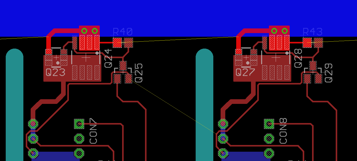

Working on a PCB design, and Ive completed  the layout, but Eagle is telling me there are seemingly some things that still need to be done.
Take the attached screen shot for example. Ive selected a net, which highlights all of the nearby pads/traces etc that are part of it. But there are airwires telling me I still need to connect something?
Can anyone tell me why this would be happening, and perhaps how I can get rid of them (short of connecting them the way it thinks I should, which would spoil my design.) image
Thanks!

    Indeed I did duplicate blocks of circuit in my schematic. In this case
    the parts in question all share the same net name on purpose (+5V in
    this case, and one between two pads/traces part of the GND net). But
    although I have connected them all together, and in the screenshot I
    have highlighted the net named +5V and it has highlighted everything
    correctly, its still telling me that I need to connect them together.
    It doesnt seem happy with the way Ive done it, even though it would
    appear to be valid.
    Eagle doesn't know you intend your copies to be treated independently.
    As Rob already explained: manually named nets (especially those
    connected to power symbols) in the schematic don't get renamed when
    copied.
    So your 'independent' sub-layouts share them and eagle therefore shows
    air-wires connecting them.
    Lorenz

    In Tom's case I think he is actually intending the copies to be connected and not independant. It looks like this is a bug that I have seen only a couple of times where EAGLE has a bit of a moment and draws air wires for nets that are already connected.
    Best Regards,
    Rachael

    Ahhh the old immortal air wire bug. I had a board once where a single air wire stayed despite all attempts to find some minor misconnection. There wasn't one. In the end I closed the schematic, renamed the board, created a new empty board with the old name, copied everything across from the old board the the new board, closed everything down and reopened the schematic and board together and hey presto the air wire was finally gone! I never did work out what triggered it to happen but I did get it fixed this way.
    Ah... yes... there's a bug in V5 (don't know if the more recent ones fix
    it) that can leave invisible bits of unwanted trace on the board. They
    are associated with a net, so ratsnest adds an airwire to them, because
    they are unconnected to the rest of the net.
    That one didn't occur to me because the problem reported was not "a
    random airwire appears that ends in middle of nowhere", which is how the
    bug always seems to manifest for me.
    Anyway, the solution is simple - just rip up the offending stray bit of
    trace. At least, it would be simple if the said bit of trace weren't
    completely invisible! So far I've always managed to fix it by MOVEing
    one end of the invisible trace (at the stray end of the airwire) at
    which point the trace becomes visible and can be ripped up. It usually
    takes a few goes, though, because the trace isn't immediately visible to
    the MOVE command, either.
    I think this was subtly different. I could get the pesky air wire to show in
    completely different parts of the net depending on how I ripped it all out and
    re-drew it. It was really really weird. In the end the only way I could find
    to sort it was to copy and paste everything to a new blank board and the rogue
    air wires were removed. Unfortunately I don't have a copy of the board in the
    state showing the issue anymore so I can't send it on to CADSoft to investigate.
    As Rachael wrote, feel free to send the board to support@cadsoft.de.
    So we can invsetigate.....

    Yup, have clicked ratsnest a million times while working in other areas of the board. image
    Theres nothing overlapping that would break or interfere with the continuity of a trace.

    0 autodeskguest over 10 years ago in reply to tomstorey
    On 07/09/16 19:01, Tom Storey wrote:
    Indeed I did duplicate blocks of circuit in my schematic. In this case the parts in question all share the same net name on purpose (+5V in this case, and one between two pads/traces part of the GND net). But although I have connected them all together, and in the screenshot I have highlighted the net named +5V and it has highlighted everything correctly, its still telling me that I need to connect them together. It doesnt seem happy with the way Ive done it, even though it would appear to be valid.
    Have you run RATSNEST on it? It's possible for unnecessary airwires to
    be left if you add copper other than by the "route" tool (or even if you
    route specific ways) but ratsnest forces a re-calculation.
    Alternatively (and this can be hidden by a ratsnest) there may be traces
    that overlap without actually joining. Eagle will consider that an
    incomplete track and will leave an airwire. After re-calc that tends to
    be a very short one that you'd easily miss...
