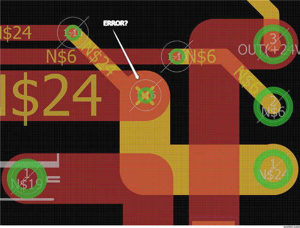

This is a via error?
d_a_n
d_a_n over 9 years ago
I manually added a via on a route and I see a X on this via. Also, I have NO ERRORS after checking with DRC.
This is a print screen, hope to help you to understand my doubts.
Something's wrong with this design?
Thank you,
Dan

    On 18/12/16 12:01, Mario-Daniel Soare wrote:
    I manually added a via on a route and I see a X on this via. I have no errors after checking with DRC.
    This is an error?
    It's an airwire. The net requires a though-board connection that hasn't
    been routed. This is probably because manually adding vias is the wrong
    method, and it's also possible the via is a different net (although that
    ought to give a DRC overlap error). It looks to me as if the via isn't
    exactly centred on that cross, so it could be just that one of your
    traces (probably the diagonal one) stops short of the via and isn't
    "connected" (even though there's clearly enough overlap to make the
    electrical connection).

    0 d_a_n over 9 years ago in reply to autodeskguest
    Solved! Thank you so much!
