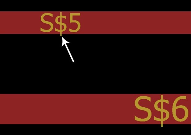

Is it possible to hide the yellow label name from signals in the board?
I've this problem:
As you can see the label/name of the signal is displayed on the net, cousing a problem when exporting as image, it will display that part of the name in my image. I want to hide all labels/names from the board. I've flagged only "TOP" as visible.

    Hi,
    go to menu Option - Settings - Miscellaneous ->  checkbox item "view signal names" - uncheck it.
    - you can it switch on or off every time you needs this.

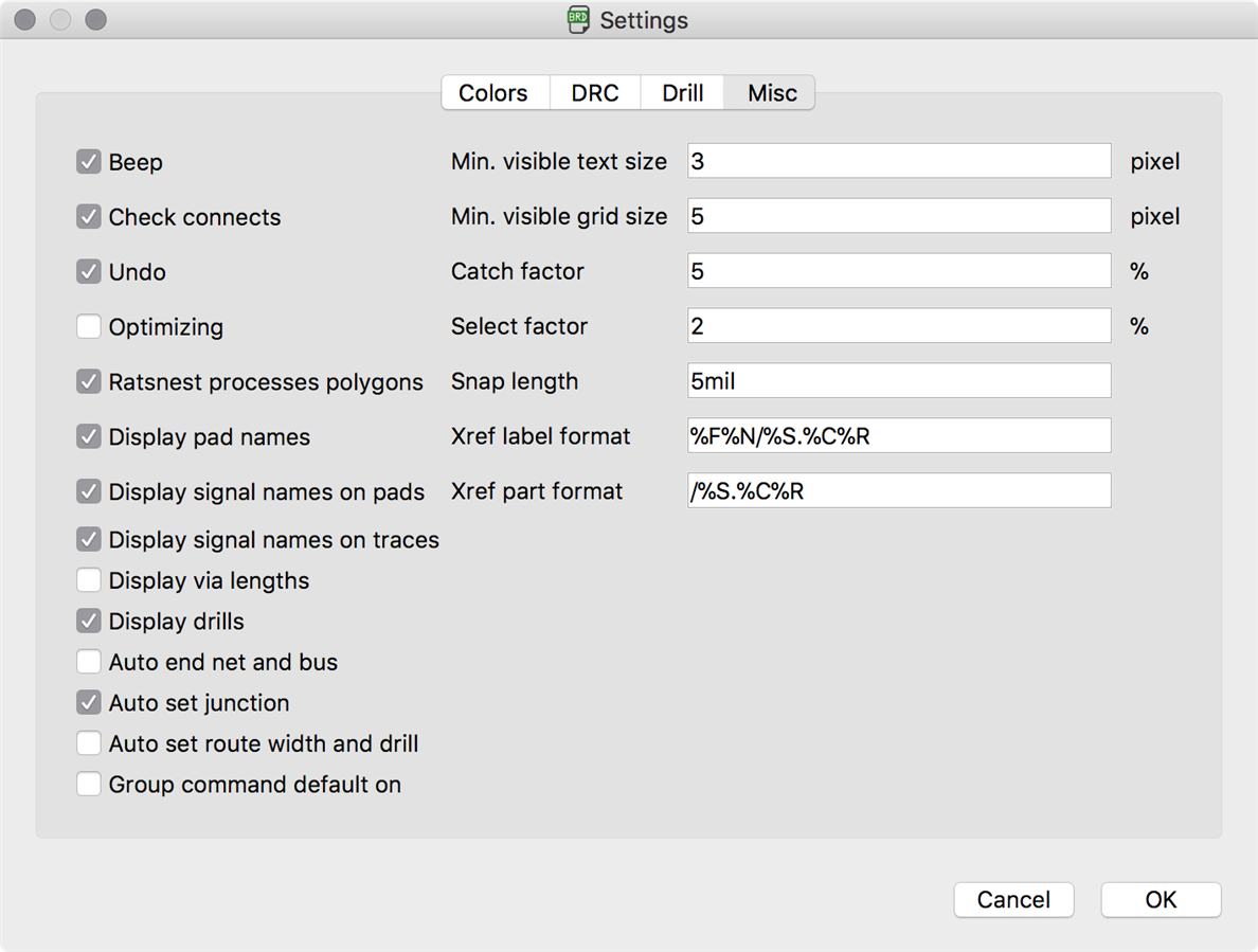

    -Tom
    Hi Tom,
    This option is available on the Mac in 8.7. From the board editor, Options->Set...->Misc then there are two options "Display signal names on pads" and "Display signal names on traces".
