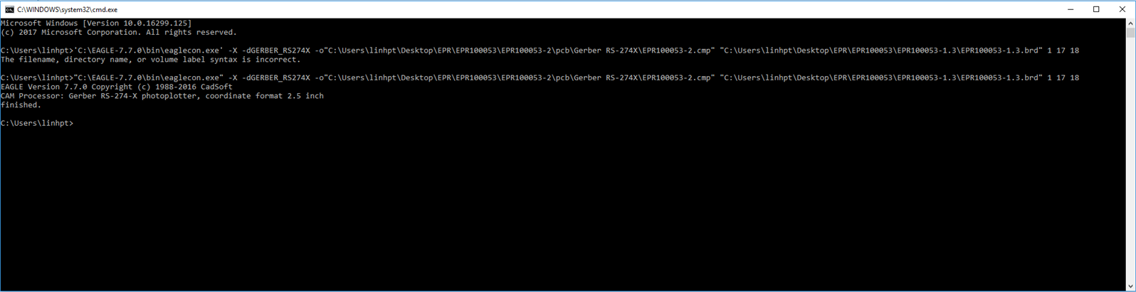

I'm using Eagle 7.7.0 and making ulp file to generate all gerber/drill files.
My code is
int pos = strstr(EAGLE_PATH, "eagle.exe");
dir_eaglecon = strsub(EAGLE_PATH, 0, pos) + "eaglecon.exe";
dir_eaglecon = replace_string(dir_eaglecon , "/" , "\\" );
gerber_cmd = "cmd.exe /c " + dir_eaglecon;
string s;
sprintf(s, "%s -X -dGERBER_RS274X -o\"%s\\%s%s\" \"%s%s\" %s", gerber_cmd, dir_gerber, release_name, gerberNames[i], dir_original, filename(B.name), gerberUsed[i]);
system(s);
it works perfectly with eaglecon.exe in C:\EAGLE-7.7.0\bin\
When I install program to C:\Program Files (x86)\EAGLE-7.7.0\bin\  ==> Error message: "...is not recognized as an internal or external command, operable program or batch file."
I'm aware that the new path of eaglecon.exe has "space" and need to be surrounded with quotation marks, so I update my code like:
gerber_cmd = "cmd.exe /c " + "\"" + dir_eaglecon + "\"";
However, the system(s) return 1 (Error) and cannot generate gerber file. In addition, when I manually type the command in cmd line, it also works perfectly with quotation surrounded eaglecon.exe path.
Please kindly help to get it works with my new program directory. I've tried setup new path in environment variables but does't work so far.

    Hello Warren
    Both the single/double quotes don't work. Below is the output that I printed out .txt file. (I re-installed to C:\EAGLE-7.7.0, but still prefer to solve this issue for all users)
    EAGLE_PATH:
    C:/EAGLE-7.7.0/bin/eagle.exe
    EAGLECON_PATH:
    C:\EAGLE-7.7.0\bin\eaglecon.exe
    gerber_cmd:
    cmd.exe /c 'C:\EAGLE-7.7.0\bin\eaglecon.exe'
    s: cmd.exe /c 'C:\EAGLE-7.7.0\bin\eaglecon.exe' -X -dGERBER_RS274X -o"C:\Users\linhpt\Desktop\EPR\EPR100053\EPR100053-2\pcb\Gerber RS-274X\EPR100053-2.cmp" "C:\Users\linhpt\Desktop\EPR\EPR100053\EPR100053-1.3\EPR100053-1.3.brd" 1 17 18
    system(s): 1
    s: cmd.exe /c 'C:\EAGLE-7.7.0\bin\eaglecon.exe' -X -dGERBER_RS274X -o"C:\Users\linhpt\Desktop\EPR\EPR100053\EPR100053-2\pcb\Gerber RS-274X\EPR100053-2.ly2" "C:\Users\linhpt\Desktop\EPR\EPR100053\EPR100053-1.3\EPR100053-1.3.brd" 2 17 18
    system(s): 1
    s: cmd.exe /c 'C:\EAGLE-7.7.0\bin\eaglecon.exe' -X -dGERBER_RS274X -o"C:\Users\linhpt\Desktop\EPR\EPR100053\EPR100053-2\pcb\Gerber RS-274X\EPR100053-2.ly3" "C:\Users\linhpt\Desktop\EPR\EPR100053\EPR100053-1.3\EPR100053-1.3.brd" 3 17 18
    system(s): 1
    s: cmd.exe /c 'C:\EAGLE-7.7.0\bin\eaglecon.exe' -X -dGERBER_RS274X -o"C:\Users\linhpt\Desktop\EPR\EPR100053\EPR100053-2\pcb\Gerber RS-274X\EPR100053-2.ly4" "C:\Users\linhpt\Desktop\EPR\EPR100053\EPR100053-1.3\EPR100053-1.3.brd" 4 17 18
    system(s): 1
    s: cmd.exe /c 'C:\EAGLE-7.7.0\bin\eaglecon.exe' -X -dGERBER_RS274X -o"C:\Users\linhpt\Desktop\EPR\EPR100053\EPR100053-2\pcb\Gerber RS-274X\EPR100053-2.ly5" "C:\Users\linhpt\Desktop\EPR\EPR100053\EPR100053-1.3\EPR100053-1.3.brd" 5 17 18
    system(s): 1
    s: cmd.exe /c 'C:\EAGLE-7.7.0\bin\eaglecon.exe' -X -dGERBER_RS274X -o"C:\Users\linhpt\Desktop\EPR\EPR100053\EPR100053-2\pcb\Gerber RS-274X\EPR100053-2.sol" "C:\Users\linhpt\Desktop\EPR\EPR100053\EPR100053-1.3\EPR100053-1.3.brd" 16 17 18
    system(s): 1
    system(s): 1
    I also tried to copy-paste string 's' to cmd line, the result below:
    With single quotes '' - Syntax Error
    With double quotes "" - Worked
    So I guess using double quotes is correct, but don't know why system(s) failed to execute the command.

    After read thoroughly the article from Warren, I understand and solve this issue. The correct way is using ^" to surrounding path.
    gerber_cmd = "cmd.exe /c " + "^\"" + dir_eaglecon + "^\"";
    output:
    s: cmd.exe /c ^"C:\EAGLE-7.7.0\bin\eaglecon.exe^" -X -dGERBER_RS274X -o"C:\Users\linhpt\Desktop\EPR\EPR100053\EPR100053-2\pcb\Gerber RS-274X\EPR100053-2.cmp" "C:\Users\linhpt\Desktop\EPR\EPR100053\EPR100053-1.3\EPR100053-1.3.brd" 1 17 18
    system(s): 0
    Thank you Warren!
