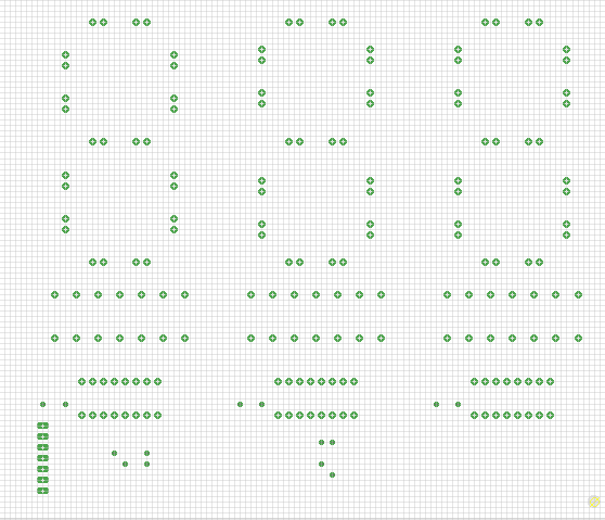

Hi!
I'm trying to export the .drd files for a CAM work with the excellon profile. The problem is the following, these are the Pads, Vias and Holes planes, so my drill should have onlye these points. image
And this is what I get:
As you can see at the left part there are some holes that should even exist, and in the upper and right part a whole part of the board is missing. Does anyone have had this same problems?

  • rafaellehmkuhl
    0 rafaellehmkuhl over 8 years ago
    Sorry for taking this post back, but to me it looks like the problem is not solved, even using legacy Excellon CAM job.
    I tried three viewers (webGerber , GerbV and FlatCAM), and all of them gave me the same problem: scaled drill points with respect to the gerber.
    This is the export from Eagle 8/9 (using legacy Excellon) notice that the drill point are all over this green area, when the components are all on the bottom right corner):
    This is the export from Eagle 6, with the same CAM files (default Gerber and Excellon CAMs):

  • techsupport
    0 techsupport over 8 years ago
    Hi,
    As Rachael stated, using the legacy EXCELLON CAM processor should work just fine. Make sure you are setting up your Gerber/Drill viewer correctly for drill file with the following parameters:
    Leading Zeros suppressed
    2.5 format
    Absolute values
    Inches
    Make sure not to convert the legacy CAM job to the new format.
    I hope this helps.
