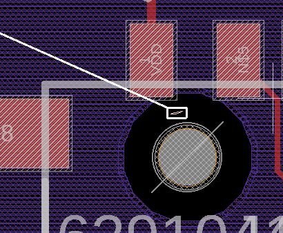

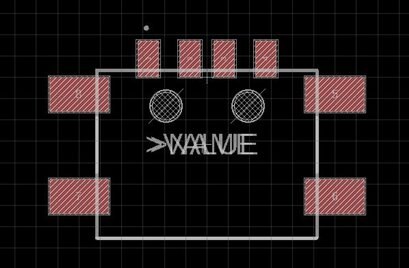

I am a newbie with Eagle, and i have spend a lot of time on Google to find an answer to my problem, but no luck. I get a dimension error between the holes and the pads in a smd USB receptable. How can i correct this problem? Thanks.
This is how the package looks in the library:

    You need to either edit the part or just accept the DRC violation in your design if you're happy that it's OK.

    You can modified the settings in the DRC rules, under 'Distance', Drill/Hole to eliminate the error.  This should not create any 'real' issue for you board as the holes are most likely for plastic (non-conductive) pins.
    Good luck!
    Gene

    Since the package is consistent with the datasheet, i guess that only accepting the errors is an option. In your opinion, is there a problem in doing that, in this specific case?

    If you're happy that the footprint is OK (and it looks like it is) then it's fine to accept this "error".
