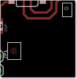

I just started a board using eagle for the first time.
I am stuck, can't delete some vias and two overlapping tracks.
I spent three days reading tutorials and I searched everywhere I cannot find a solution to this problem.
I have uploaded some pictures.
The areas highlighted are the ones I am concerned with.
Thanks for your help.

    One cannot compare one program with the other directly.
    The errors shown could be from the DRC and would be erased by ERRORS
    CLEAR in command line.
    Easiest would be if you zip your eagle files and place them here (if
    they are not top secret), so eagle users could check them.
    BTW it's always good to tell the eagle version.

    Which version of Eagle?
    As Joern says, those look like DRC markers but, unless you're on an
    older version, removing the cause of the error should clear them. At
    least since V9.0 - I can't remember when it changed but V7 needs the
    explicit clear command.

    Good afternoon, Chris,
    David, Joern and Rob all provide good suggestion on how to find the
    errors.  I know that Joern and Rob have been around Eagle pretty much
    since the oceans formed.  Well... maybe not quite//that long.
    The command you seek is the "Ripup" command.  When a trace is deleted,
    the board editor is trying to delete the entire signal, which can only
    be done in the schematic in order to maintain consistency between the
    schematic and the board.  By doing a ripup, the board editor will leave
    what's called an air wire (usually a thin yellow line), which is an
    indicator that routing is incomplete.  The air wire will have the same
    end points as the trace that was ripped up.
    After several ripups, you may find that the air wire meanders where you
    don't want to place a new trace.  The mesh of air wires can be
    recalculate with the "Ratsnest" command.  Bear in mind that after a
    Ratsnet, the air wires will be generated between an unrouted pad and the
    nearest wire endpoint that's on the same net as the pad.  The shortest
    distance route may not be the proper or optima path.  A case in point is
    when implementing a star ground - where the ground from each subsection
    of your circuit are all routed to the same via.

    0 neweagleuser over 7 years ago in reply to dukepro
    Thank you for responding.
    For the record I am using v8.2.
    I got two more unneeded vias. The only way I got rid of them was to move the files from my desktop to my laptop,
    only then did the ripup and ratsnest commands work.
    In the situation (above picture), I found a better way to route the track without using two vias.
    The only way to get the track routed where I wanted was to move the vias outside of the dimension lines and proceed.
    Now I can't delete the vias  (until I move the files over to the laptop as mentioned above).
