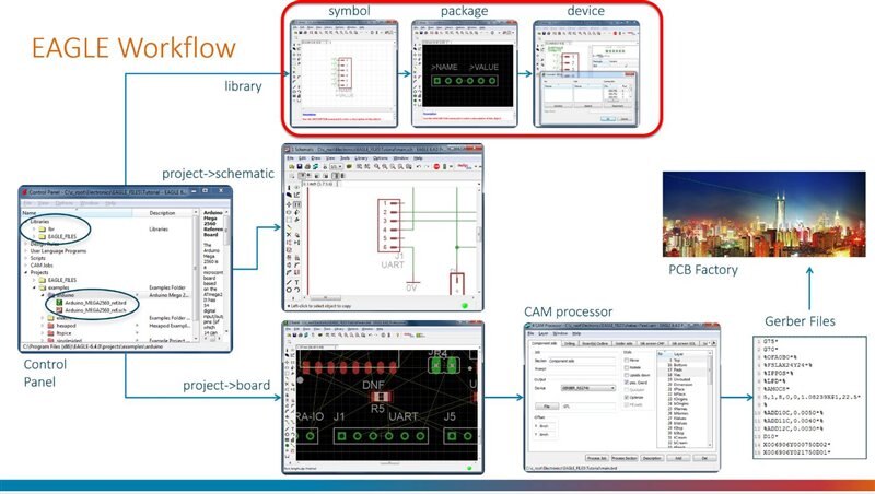

    Such a shortcut (drawing the fingers in the Board view) is not recommended, the best approach is to create a part, i.e. a Device (i.e. create a Package, and create a Symbol, and then associate them together to make a Device) to represent the edge connector.
    In other words, focus should be on the red highlighted areas of the EAGLE workflow processes.
    For detail, see parts 1, 2 and 3 in the tutorial by rachaelp , here is the link to part 1:
    EAGLE Tutorial: Library Part Creation Part 1 - Creating Packages
