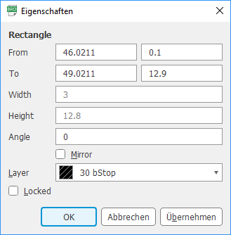

Hello,
is it possible to change the size of an existing rectangle.
So i would change the size of many rectangles
I want to change the "from" and "to" value:
In from i want to minus a value to the existing one
in to i want to add a value to the existing one
Thanks
Bruno

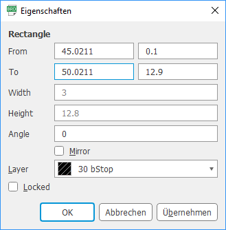

Example: Original:
After change

    0 autodeskguest over 7 years ago
    well, you can change the values in the dialog ... 8-)
    not out of the box, but one could create an ULP to do it.
    As you can't easyly change an existing rectangle, I would just create
    new rectangles with the modified size and delete the old ones.
    Alternativly you could set the grid to the value you want to change
    your rectangle and drag the edge(s) with left mouse + ctrl button
    Lorenz

  • autodeskguest
    0 autodeskguest over 7 years ago in reply to Snoopy354
    Can someone help me with the ulp,
    or can you give me an example?
    | string cmd;
    | sheet(SHE) { // access the sheet context
    |   SHE.rectangles(REC) { // loop through all rectangles on sheet level
    |     if (ingroup(REC)) { // only process grouped rectangles
    |       sprintf(cmd, "%srect (%fmm %fmm) (%fmm %fmm);", cmd, u2mm(REC.x1) - 1, u2mm(REC.y1) - 1, u2mm(REC.x2) + 1, u2mm(REC.y2) + 1);
    | exit(cmd);
    copies all grouped rectangles to the currently selected layer, adding
    1mm on all sides
    if you use
    | exit("delete (>0 0);" + cmd);
    as the last line, the original rectangles will be removed, leaving
    only the copies.
    Lorenz
