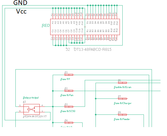

Hi!
I am new using eagle.  Please I will use this schematic for High current
Please how cant separate ground and VCC
global  wire for VCC is haigh current  but Vcc from pin connector as example A12 is smaller so Current VCC global is the some of current Vcc at every Pin A12, A11......A1.
in width rules net class I want to give Vcc global as examples 345Mil but every Vcc A12...A1 as example 65Mil.
Its idem for GND.  It wiill be de same two width rules net class
I hope you understand what I mean

    Hi Hamid,
    as far as I understand you, your Power-VCC is the same as the "normal"
    VCC (the GND as well) and you only want different width for it. In Eagle
    same name is the same thing. That means you need to give one of them a
    different name, lets say VCC_PWR /VCC_GND. When you are finished with
    your design you may connect both vcc together and accept the ERC error.
    This tip goes for Eagle Ver. 7.
    Please always tell your Eagle Version so people can give you precise help.
