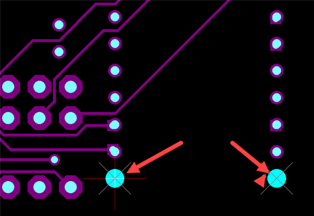

    I think they are not happy about this:
    There are four holes like this, which have very thin copper sliver around them. I think you used a via or pad to create these, when you probably wanted to use a drill hole only.

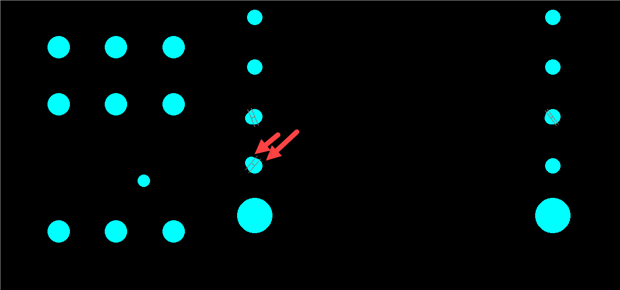

    Incidentally, there's another severe issue here:
    As you can see, there are two holes overlapping. That will cause them to send the design files back to you too. There are lots of places on that component which have these overlapping holes.

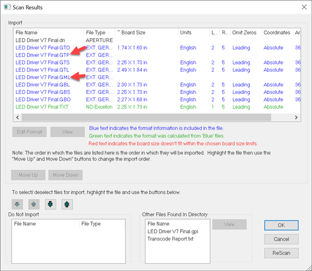

    It also noticed something weird about a couple of files:
    For some reason, the files marked with a red arrow have nothing in the 'Board Size' column. I don't know the reason. You might need to check the EAGLE CAM processor settings for those two output files. There also was no board outline file (not all manufacturers need that, but some do).
