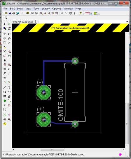

F/B annottation has been severed!
e14 Contributor
I'm a new user of the of Eagle pcb design software.  And after a few totorials I have been making simple test circuits and boards but on my last two projects I seem to have run into this error: "F/B annottation has been severed!" see below.  I must be doing something simple wrong, any help? image

    This usually happens if you do not have the schematic and board both
    open while editing. It is usually not too hard to reconcile them.
    Run the ERC and reply if you need help figuring out the results.
