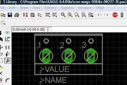

Hello,
I am new to Eagle and already spen a day with no result. I am looking for a library part which seems inexistent. I need a part equivallent to http://www.futurlec.com/Connectors/PCBT3.shtml. The closest i found is a wago with 5.08mm pitch image
Thanks in advance for your help
Guy

    I did as you said. With the 1mm grid one can see that holes are more than 5 mm apart, with 1.27 it's precisely 4 squares (as far as naked eye can see) so i am not sure what it was that you meant that i discover in this little trip image

    I will try to take you a small trip into a new board. Start eagle, then file-new board - find view in top menu - click grid.
    Change inch to mm - use only 1.0 and set grid on. Now ADD con-wago-508 and take w237-3E, place it on the grid and count the lines
    between two pins. Then you can go back to 1.27mm grid.

    Thanks Mogens, It seems that it's .2" pitch as on a .05' gride it takes 4 places. Am i mistaking?

    0 e14 Contributor over 13 years ago
    Hi Guy.
    What you need, could that be con-wago-508? The package W237-3E has 5mm from center to center of the pins.
    Mogens

    With only 3 pins a 5mm part is equivalent to 0.2"
    It is part of the learning curve to make your own lib parts.
    One of the reasons is you should verify every lib part you use. This
    takes about as long as making a part from scratch and you save the time
    looking for the part.
    Paul
