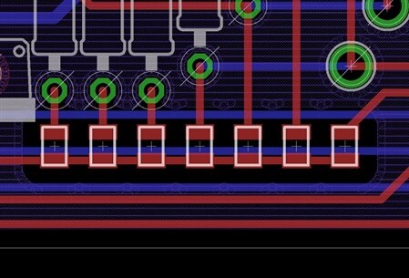

I've built a board with a number of custom SMD components on it (mostly little LED's), and am having an odd response from the routing of the GND/PWR planes that are run throughout for signal isolation. Everything is fine for the other SMD components (amps, gates etc), but the routing of the inner planes gets funky around the LED's. Is there something wrong with the custom components that could be causing this problem? They're pretty simple, and I built them with the same process that I used for the others.
I should also note that the area is littered with DRC "Distance" errors, for both the Top and Bottom routing layers. This is also confusing to me, as the components should not interact with anything on the Bottom layer...
Thanks everyone
Edited to include DRC error information

    Is it possible that the outline of the LED is on layer 20 (dimension)?
    It seems to me that the color of the body from the resistors and the
    LEDs are not the same.
    Cheers Patrick

    Instead of layer 20, you may have wanted to tPlace.
    I was looking at the pads of the resistors, as well.  It appears that
    they will short to the polygon on the inner layer.  Have you set the
    isolate value of the polygon?  It will probably get rid of some of the
    DRC errors.

    Patrick, you got it in 1!
    Not quite sure how that happened, but I managed to lay down the dimensions using the wrong layer when I built the first LED, then duplicated the improperly built component for the different LED variations.
    I shifted all the dimension layers to the tPlace layer (as per Chuck), and the routing is now fixed thank you so much.
    Chuck,
    I hadn't done anything to modify the polygons after laying them down and you're correct, they auto'd to 0 isolation. I'm not dealing with too much power, but have bumped that isolation up to a value of .016. Thank you for that insight, I wouldn't have given it a second thought.
    Thanks again everyone, I really appreciate the quick and on point advice

    The polygons should have pulled back a certain distance anyway even with
    the isolation value at zero.  Setting that value on the polygon takes
    care of that particular polygon, but it does not address other
    clearances.  Double check your DRC->Clearance tab and make sure you have
    something reasonable there, as well.  The Wire-To-Pad distance may be
    sitting at zero, or close to it.
