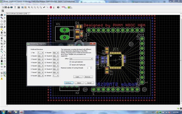

    After I click Evaluate, I don't see any icons like Autorouter icon on the bottom right of the screen. And I don't see the line "Continue existing job" in the Autorouter Main Setup". Can you help me? I use EAGLE Light version.

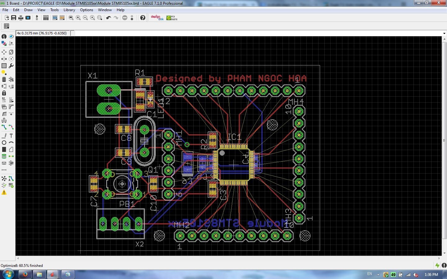

    I clicked Evaluate, but I didn't see anything at the bottom right! Here are some pictures!

    I have updated Eagle to 7.2 and noticed that the evaluation icon in the lower right corner no longer appears after running the autorouter. Please check into this problem as it is a significant time issue to run a moderately complex board.
  • Former Member
    0 Former Member over 11 years ago in reply to Former Member
    Hi,
    You are right! I also have updated to version 7.2. This function has effect with a moderately complex board. Thank you so much!
