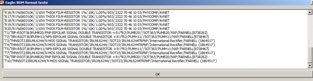

I'm using a goog BOM generator written of course with ULP, the last and only enhancement I would like to do is around the display.
The BOM is both written in a file and directly display by dlgTextView() function.
But the dialog box displayed is VERY small and lines are wrapped! and using the mouse to expand it is very boring when i'm in optimizing phase of my design....
do you know an option or a way to make it larger????

    but unfortunatly it does'nt work :
    here is my code :
    dlgDialog("BOM format texte ")
                                dlgHBoxLayout
                                    dlgHBoxLayout {dlgSpacing(250);};
                                    dlgTextView (TextBOM);
                                dlgPushButton("OK")
                                    dlgAccept();
    and the result is : image
    sorry.....image

    Just a little wrong. The spacing to make the TextView wider has to be in
    the Horizontal layout within the default vertical layout of the
    dlgDialog().
    dlgDialog("BOM format texte "){
                dlgHBoxLayout{dlgSpacing(500);}
                dlgTextView ("TextBOM");
                dlgPushButton("OK"){dlgAccept();}

    0 Former Member over 11 years ago in reply to autodeskguest
    hi!
    you 're a genious ! I have spend hours on this trick! and U solve it in minutes (in seconds in fact)!
    Great thanks!
