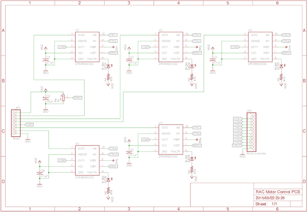

I'm a newbie to use Eagle CAD to design PCBs. I have just finished the schematics; however, it seems like there are several issues that I have to resolve before moving on.
Here is the schematic that I have designed

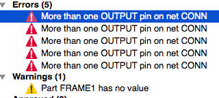

but after running ERC, it shows the following errors.
How should I fix these errors & warnings before moving forward?

    For an answer to the first 4 errors, have a read here: EAGLE Central Forums: eagle.support.eng » multiple pins on net

    The frame does not necessarily need a value, so the error could be approved.

    Does that mean these errors can be approved if the MPU is able to exclusively control the DRV8832 via IN1 and IN2?
