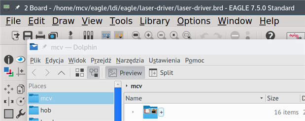

Hi again.
I use the 4K monitor (about 210 ppi) and Eagle has a little bit too big fonts for me. It's great to have adjustable icon sizes, but I can't find any option to adjust font sizes. Is there any?
If not, then I request a setting in GUI options to scale fonts. It is doable?
Attached screenshot.

    That doesn't help. Still the font sizes set in the settings are far from what Eagle displays. Also I would have to have tiny, unreadable fonts everywhere to have Eagle display what I consider as normal. image

    Am 25.04.2016 um 11:08 schrieb Zdzisław Dyrman:
    Yes, I'm using KDE. I have all my fonts set to 7 points. Eagle's fonts
    are way bigger than anywhere else. For comparison Eagle and file
    manager:

    I'm using KDE as well. If I go to System Settings, Appearance and then
    Fonts and change the "General" font setting, EAGLE reacts on this after
    a restart of EAGLE.

    Yes, I'm using KDE. I have all my fonts set to 7 points. Eagle's fonts are way bigger than anywhere else. For comparison Eagle and file manager:image

    I think Zdzislaw is working with Linux, but also there EAGLE
    reacts on the font settings in your window manager.

    Ah. That's a different story. I think you are stuck with them unless you change the Windows defaults under themes which should conform.

    The text command refers to the drawing, doesn't it? I want UI font sizes to be changed, since they're too big. ;-)

    Read the text command for choices of font (big warning) and text height using change command. EAGLE Help: TEXT
