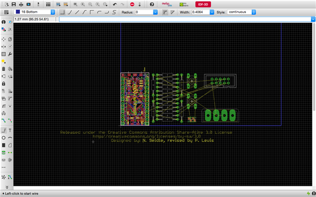

  • Former Member
    Former Member over 10 years ago in reply to autodeskguest
    Screen shot below, the frame for the board limits seem to be from the bottom left of the Arduino board but I can't get the outline of the limits of the board (100mm x 80mm) to display. I've realised I can move my components to the right of the Arduino so I'm guessing the board limits are working just not showing. My other problem is I don't seem to be able to rotate the group of components making up the arduino board. Any ideas?
    Thanks for your help
  • Former Member
    Think I'm getting there image I used the wire tool to draw a rectangular limit to the board size max of Eagle Lite the place my compost accordingly, I still can't rotate the arduino component though so any guidance would be appreciated.
    Thanks in advance
  • autodeskguest
    autodeskguest over 10 years ago in reply to Former Member
    Well, first, there should normally be an outline of the allowed area in
    layer 20 when you first create a board. Eagle does this specifically to
    help with what you're currently going through. However, you've got past
    that now, so...
    You won't be able to rotate the arduino in situ if its bottom left
    corner is at the origin. To do so would put some of the pins outside the
    valid area to the left. Instead, you should MOVE it. Drag it away into
    the free space above and to the right, then right-click to rotate it
    while moving. Now place it somewhere completely within your blue box and
    it should work.

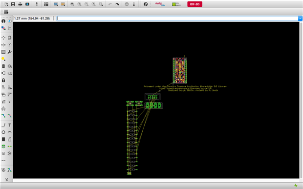

  • Former Member
    Any ideas, how I get the outline of the permited board area to display? I've also got problems with one air wire, I've tracked it down to none terminated pins on a couple on connectors, how do I terminate these pins, i.e. let the eagle know they have no purpose in the circuit ?
    thanks in advance
    Steve

  • Former Member
    I've had one air wire for ages, I found an un routed net and corrected it, re did autorouter and RATSNEST but it didn't resolve the problem so I deliberately added an un routed net to check RATSNEST was working. As I thought it would, it now reported two air wires. I un did the deliberate un routed net and now I have two air wires. Both I now suspect are not there but eagle is not refreshing. Any ideas ho I can  resolve the air wires issue. I now suspect both air wire are not present.
    thanks
