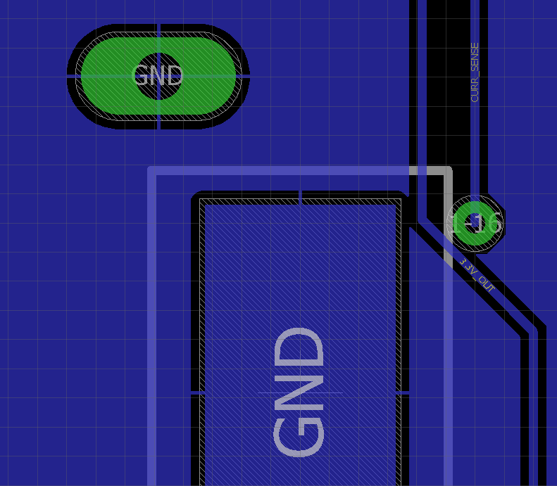

Hi everyone,
Looking for any tips on increasing the size of the connection traces between pads that should connect to the ground plane. See those spindly connectors between the GND pads to the GND plane? How do I make them larger, as I need to pass some significant current through them?
Thank you!!

    Am 18.11.2017 um 22:54 schrieb Nevin Steinbrink:
    Hi everyone,
    From
    HELP POLYGON
    Thermal dimensions
    The width of the conducting path in the thermal symbol is calculated as
    follows:
    Pads: half the drill diameter of the pad
    Smds: half the smaller side of the smd
    at least the width of the polygon
    a maximum of twice the width of the polygon

    Hello,
    The width of the connections is determined by the line width used for the polygon.
    Best Regards,
