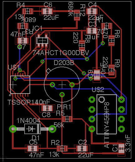

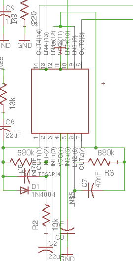

I’m using eagle and I made a series of connection on my schematic that I don’t see on my PCB and I’m wondering why? On the bottom right of the TSSOP14 IC, pins 6 and 7 on my PCB board aren’t connected to anything, but they are in my schematic? Confused as to why this happened, and if I need to now go through every connection and make sure
everything I put on the schematic is on the PCB. I’m new to this so it’s likely the problem is me. Any advice very much appreciated!

    Hi Peter,
    Your schematic has errors (you're using the 'Wire' icon instead of the 'Net' icon) but the schematic is also untidy and unreadable, please see the EAGLE training videos, they offer good advice:
    https://www.youtube.com/user/EAGLECadSoftComputer/videos
    The PCB could also be improved significantly (right now you will have errors, in the schematic too, but you will not know that unless you run the ERC/DRC), but again you might need
    to set aside a day or two to go through the training material (at the same URL).
