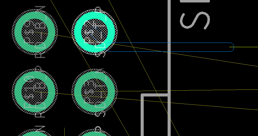

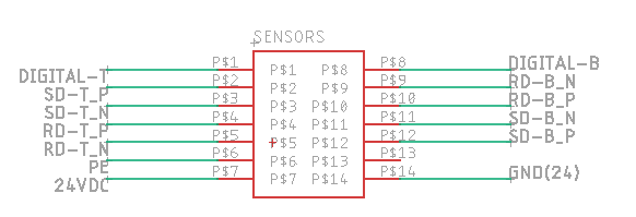

So I've done the standard reading on this from the ealge blog page, I have my traces with matching names except for the _P and _N but my traces still do not want to rout together.
I am wondering, do the differential traces require their own netclass? If I have a non-differential trace in the same netclass as my differentials, would this affect the differential routing?
Some pics:
Traces in sch:
here is the routing only doing one at a time:
Thanks in advance,

    One other data point:
    When messing around with the layout I allowed the autorouter to lay the differentials, I have since ripped up those traces but maybe that is related.
