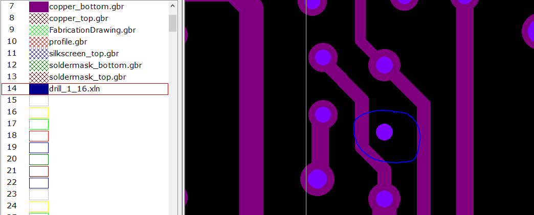

I need to place an NPTH(Non-Plated) hole in our design. whenever we place a hole, it appears with a solder mask opening(tstop layer). And we don't need the solder masking opening.
So in eagle, there is an option for removing mask opening for pads/vias. But there is no option for drill without the solder mask opening.
Please help me out how to place a drill(NPTH hole) without a solder mask opening.

    bino over 5 years ago in reply to Jan Cumps

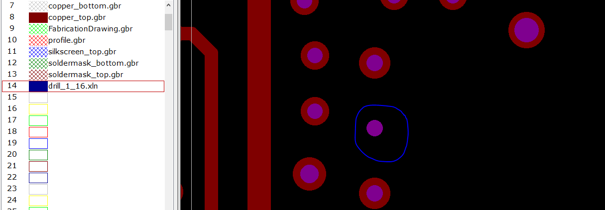

    I tried via with drill size less than its copper diameter so it removed the soldermask covering.
    But it has an issue in Gerber. There add an extra part in top/bot copper layer.

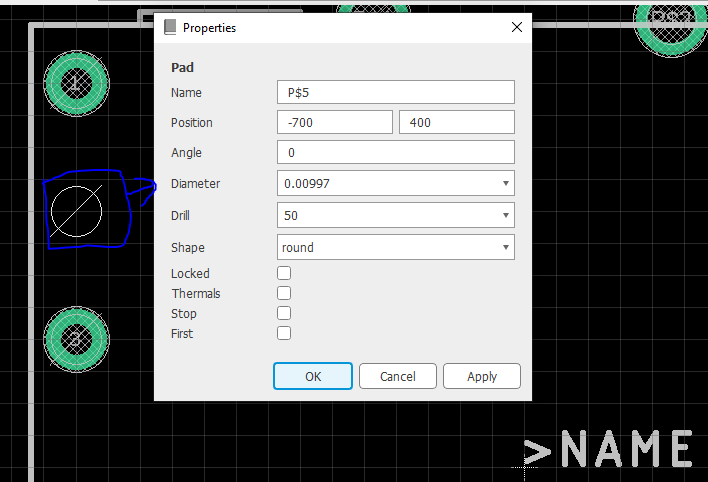

    Marked pad is actually an NPTH hole. But it appear in top/bot copper layer.
    And fig1 is properties of this pad.
