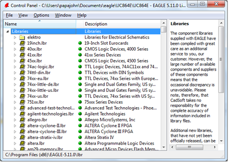

    Hello, Mr. Hammerl -
    I am new to Eagle, as well as to electronics for the most part, and to Mac.  (Three strikes?)  Mac is the biggest problem - I am a Windows keyboard guy of old.  Sorry for the vent - it's quite an adjustment.
    With the help of some tutorials, I created a new device (symbol/schematic & package/layout) in a new library (which Eagle placed in the Eagle directory, but I moved to LBR).   However, the library does not show up in the ADD list.  I must have done something wrong, or skipped some step.  The pins are numbered the same, the layers are correct, I give up.  Riddle me this, Batman!
    Thanks very much for your help.
    Hi Dean,
    I suppose the library is "not in use" yet. This means it is copied in the LBR sirectory but yoiu have to "use" it before it appears in the ADD dialogue.
    Could you check the EAGLE Control Panel tree view and expand the Libraries branch there? Does your library appear there? And, if yes, I suppose there is a grey dot behind the library name. Click on it and it should turn green. now swith to the schematic and check the ADD dialogue.
    More info: HELP USE

    levafreidin over 15 years ago in reply to e14 Contributor
    Hello Dean,
          First, check if your library is on path there EAGLE will look for it, in Control Panel:
                    EAGLE Control Panel,
                             Options,
                                     Directories,
                                             Libraries $EAGLEDIR\lbr;< the path you want to keep your own libraries>
         Second, from schematic or layout windows, type command "use <your library name>" .
    Now this name has to appear in "ADD" list.
              Good luck!
                      Lev.
    e14 Contributor over 15 years ago in reply to e14 Contributor
    Dean
    you must go to the main window in Eagle
    in the library menu. You see all these green dots. It means that these libraries are for use. Find your library or the library you modified and click on the dot. It will turn green and you will be able to use it.
    Regards Panos
