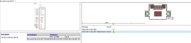

I have downloaded eagle library for micro USB-AB using exp-lbrs.ulp. Its giving me this error:
1) D:/ArduinoEaglesFiles/arduino-M0-reference-design/Arduino-M0-V1.scr, Line 1767:
Can't place smd S3 on pad P$3!
2) D:/ArduinoEaglesFiles/arduino-M0-reference-design/Arduino-M0-V1.scr, Line 1770:
Can't place smd S4 on pad P$6!
3) D:/ArduinoEaglesFiles/arduino-M0-reference-design/Arduino-M0-V1.scr, Line 2484:
Unknown pad: S3
4) D:/ArduinoEaglesFiles/arduino-M0-reference-design/Arduino-M0-V1.scr, Line 2485:
Unknown pad: S4

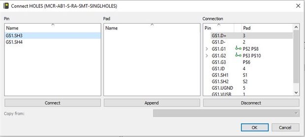

When I use the library Connettori.lbr and used device: 0631_MCR-AB1-S-RA-SMT-TRHOLES
then it says the error:
Device 0631_MCR-AB1-S-RA-SMT-TRHOLES has unconnected pin (G$1/SH3)!
Therefore, I open the Device in library:
1) In MCR-AB1-S-RA-SMT-SINGLHOLES, its not shoieng green "check" mark
2) When I click MCR-AB1-S-RA-SMT-SINGLHOLES, then I can see two pins are unconnected.
Now I am confused, where to connect G$1.SH3 and G$1.SH4. I think if I can connect this 2 pins then I can able to use the library.
Please help me out.
Regards
  • rachaelp
    0 rachaelp over 10 years ago
    Without the datasheet for the actual part or the libs to have a dig through I'd just be guessing but as you exported this from an existing design, have you had a look at the part in that design to see where they are connecting in there? I can't see how these don't work if they have been exported from a working design and are unedited. Does the existing design you exported it from exhibit any errors? Looking at the picture there are two variants in there, maybe the existing design uses the default variant and this isn't actually used there?
