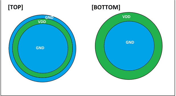

Hello guys,
I'm trying to have these planes on my PCB:
My first question: I'm only using TOP and BOTTOM layers, but assigning different planes. This makes my PCB a 2-layer one, right?

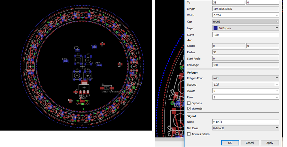

Here is the layout and the properties of the polygon used to try to do what I need:
There are 5 round polygons (using ARC) all with the proprieties assigned at the left, only changing the Signal Name and the Layer.
What am I doing wrong? It seems that there is some over-laying from the outer layers. How can I limit the "range" of a layer?

    I'm sorry for wasting your time. I've solved it by changing the Rank of the outer polygons. Thank you very much.
