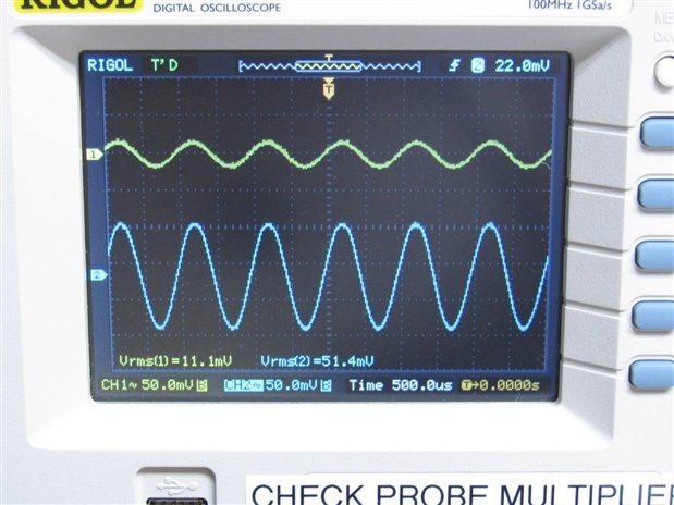

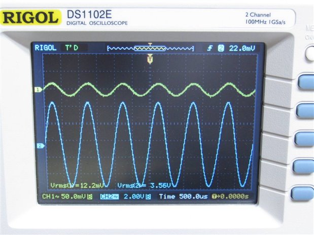

    0 jw0752 over 9 years ago
    Hi Andy and Others,
    In a new experiment tonight I wanted to see how low the input to the two transistor amplifier had to be so that the output would not clip at full volume. This turned out to be at the limits of my test equipment so my results were not very precise.
    Here we have an input of 1 kHz at 12.2 mV rms and the gain control is at max. This produces an output with no load of 3.56 V rms and an approximate gain of 300.
    In this photo we have set the gain control to minimum. While I have not changed the input from the signal generator we see that the scope is now calculating the input voltage to be 11.1 mV rms. The output with no load is now 51.4 mV rms for a gain of approximately 5. Any setting of the gain control or increase in the input that pushes the output beyond 3.6 V rms shows clipping on the output.

    0 jc2048 over 9 years ago in reply to jw0752
    You are allowed to put an attenuator at the input if you want to. The input resistance of the preamp is around 150k, so it would hardly load a simple potential divider if you keep the values low. Measure what goes into the attenuator and divide by the attenuation.
    Alternatively, have a look and see what your test meters can manage measuring AC.

    0 jw0752 over 9 years ago in reply to jc2048
    Hi Jon,
    By this morning my mind had finally realized that I wasn't at the limit as I still could switch the oscilloscope to RX1 and then I read your excellent suggestion to use an attenuator on my signal generator. I retract my statement and tonight I will recheck my readings.
