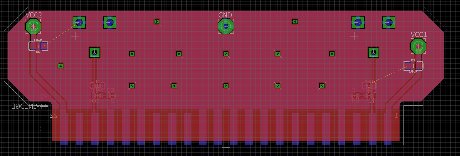

I would like to know how to make one side of a ground plane flush with the edge of a pcb in Eagle. I will draw a polygon around the perimeter of the board, and there is some kind of restriction that forces the ground plane's barrier to be in from the edge of the board. So in the picture below, I am trying to figure out how the red will go all the way to the edge where the blue sections are. Thanks!

    Open the DRC, go to the distance tab and change the clearance from the dimension setting.
